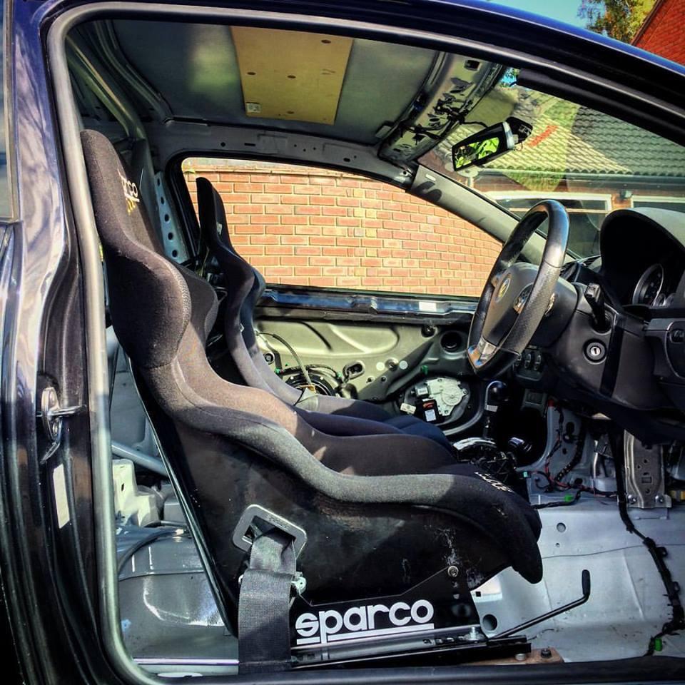

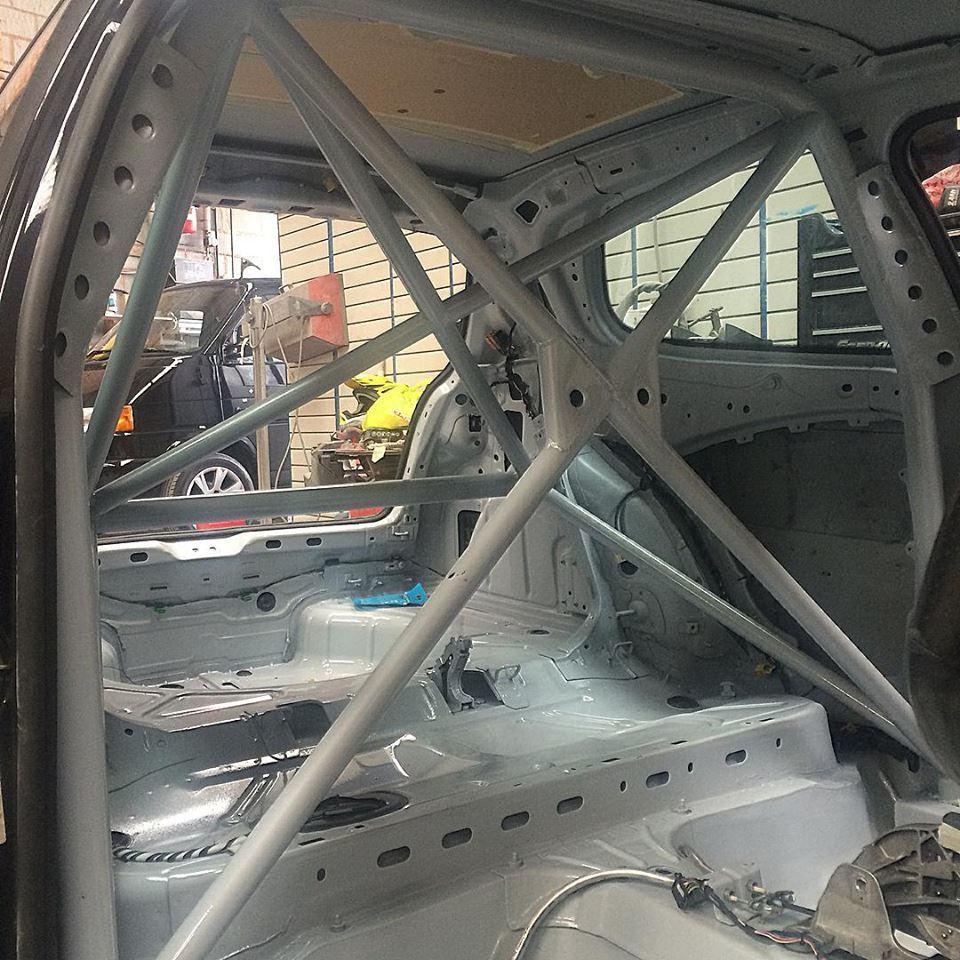

Interior- Fully stripped, just dash left. Sparco Pro 2000 drivers seat, magnum fibreglass passenger seat. Custom fully welded in rear cage by SA Motorsport. Interior sprayed in Suzuka Grey. Boost gauge steering wheel mounted.

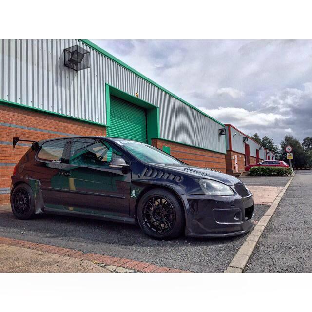

Exterior- bonnet, front bumper, front wings, rear arches, ALL off of the official 2011/12 MK5 Golf BTCC car. Rear wing custom made. Carbon GP wing mirrors.
Wheels- BBS RE1096. 1 of 8 sets ever made for the official BTCC MK5. Made from magnesium. 17x9 all round et15. Wrapped in Nankang NS2R semi slick street compounds.

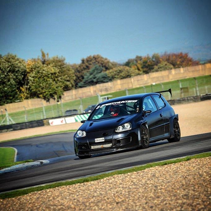

Most famous corner ever?
Donnington Park:
Not to everyone's taste  :P But tbh, look at the car I drive, i'm not really bothered. The car is built for purpose and is an absolute animal on track, various track videos of it on my instagram feel free to watch (Y)
